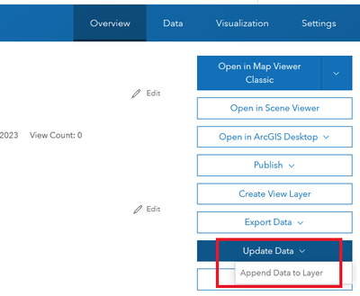

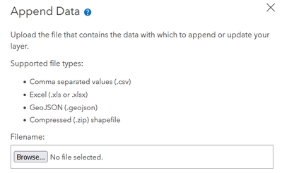

Short answer is "yes, this can be done".
It really depends on the complexity of the survey in question, and the way your data is saved. In some cases, entering the data by hand may be easier.
Start by publishing the old survey, then you can try appending data in AGOL:
You can probably use ArcPro or FME to get the data added as well, but then you may wish to wait until it's in SQL.
