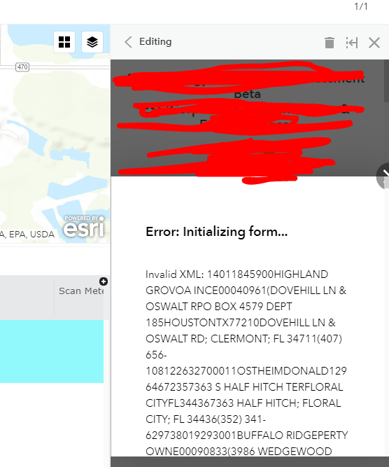

Hey All,
I'm experiencing the same problem when I load the survey into Experience builder. I get the Error: Initializing Form. I have attached the XLS form. I think the problem may reside with the search widget or the pull data function. Thanks for any insight folksExperience Builder.PNG
