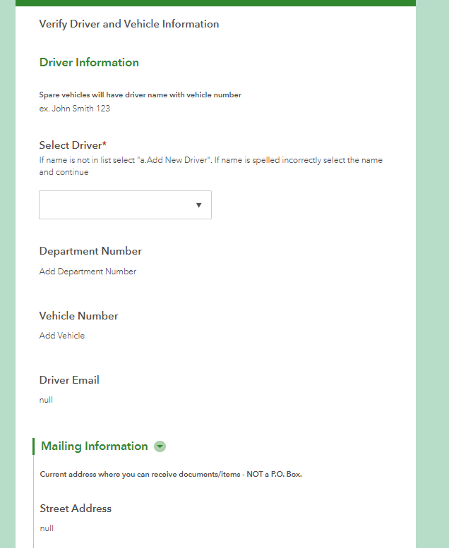

Below is an example of the opening screen before a driver is selected.
Should only show Select Driver, with questions appearing AFTER a driver is selected.
Below is what the web version looks like. The questions are already showing up before a driver is selected!
Is this a common thing in survey123 and if so how do I fix it? There will be a lot of people using the web version for some time and if the relevant column doesn't work then there will be a lot of confusion.

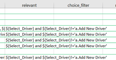

Here is an example of the logic that is used:
A Driver must be selected and cannot be a "a.Add New Driver"

I understand it may look like that works but a better way is ${Q1} != "" or string-length(${Q1}) > 0
so your example is better written as
${Q1} != '' and ${Q1}!='N/A'
Connect tends to be much more forgiving in weird syntax like that.  That is why you are seeing it not work in the web is my guess.  They work different for sure.
I suggest trying that as I have never seen the way you listed before.

No, the idea is that there is a list of driver names to select from. However, if their name isn't in the list they have the option to "Add a New Driver" so I only want certain things to show up based on different criteria. In the example above the following questions appear only if the question is selected and cannot be "Add new Driver".
This has nothing to do with checking for blanks or string length.
The problem is that the web browser is ignoring the relevant criteria and it is all showing up all at once regardless of if things are selected or not, and in this case, it doesn't matter if its selected. The questions appear when the survey opens when nothing has been selected yet.

${Select_Driver} absolutely does something.
Say you have Questions 1-5 in a survey.
When you want to open a survey and only have Q1 shown. The only way to show the other questions is if you select/answer Q1. So the notation would be ${Q1} in the relevant column for Questions 2-5. So now the only way for Questions 2 - 5 to appear is if Question 1 is selected, at this point it doesn't matter what the selection choice was for Question 1, only that Question 1 has been selected.
Now say Question 1 has 3 choices. Yes, No, N/A and you want Q2-Q5 to shown as long as Q1 isn't equal to N/A. For that you'd input ${Q1}!='N/A' in the relevant column. However, doing just that notation only makes the questions go away if N/A is selected. They will still show at the begining of the survey regardless if Q1 is answered or not.
To make them appear AFTER Q1 is selected AND if Q1 doesn't equaly N/A then you need this:
${Q1} and ${Q1}!='N/A'
Now again, going back to my problem, is that these notations do not work in the web version ONLY the APP Version.
KyleHash
Ah I see. I apologize, once you said that Connect is more forgiving that made more sense to when you said the ${} doesn't do anything.
It works properly now and I accepted as a solution.
