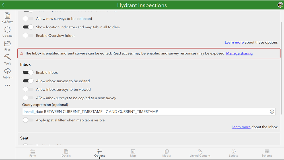

Using Survey123 Connect, is it possible to query a feature layer based on a dateTime field? I've been trying this, but have not had any luck.
IsmaelChivite
Esri Notable Contributor
Below is an example: Configures the Inbox to retrieve only records where the date value in the install_date column is now older than a week from the current date.
