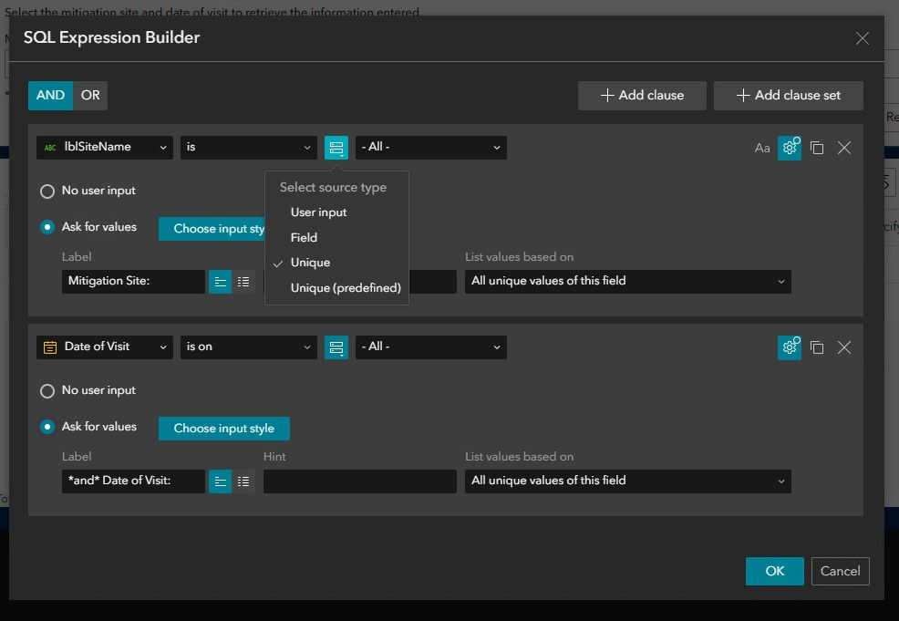

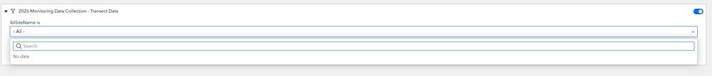

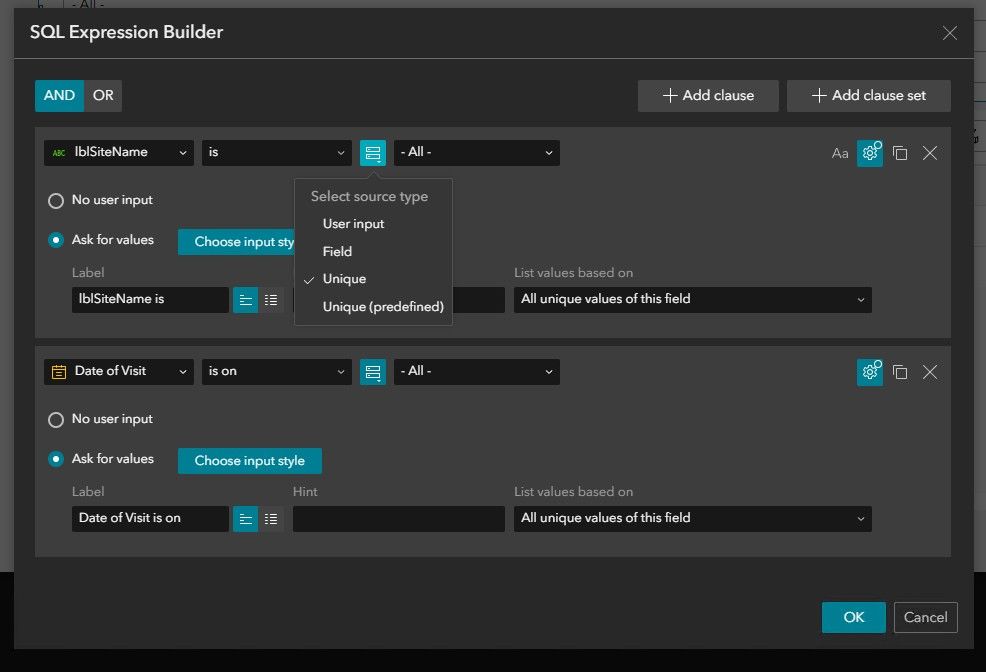

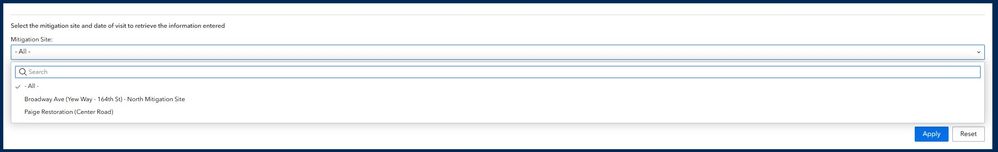

As with most things ESRI, you tend to get most of the way there before stepping on a rake & get hit in the face. Your suggestion seems straightforward enough but it's not working either. I've designed the filter SQL query in the exact same way as what I've done with the Query widget but at runtime, there are no values to select in the pulldown.
Query widget SQL design:
Query widget runtime:
Meanwhile, filter widget SQL design:
and filter widget at runtime:
