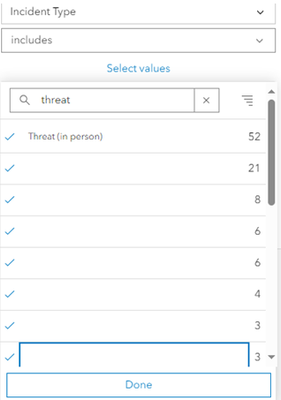

I have a survey I created in late 2020 that has a select_multiple field.  I was asked for records that met a certain criteria, which included some but not all the values that are possible in that field.  I went to the Data tab on the page for the survey, set a query using multiple 'contains' and 'or', and then attempted to Export to .xlsx or .csv or .gdb, but it just spun and I didn't get any output.
So, I pointed ArcGIS Pro at the feature service, and then attempted to set a query, but found it would not see one of the possible values in that field (which is very odd).

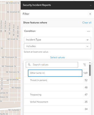

Then I tried setting a Filter on the layer in Map Viewer, which worked, except MapViewer is not displaying the values correctly...
I seem to have worked around some problem with the querying and exporting here.  How can I get this querying to work directly in the Survey123 Dashboard, and also have the values display correctly in the MapViewer filter?

Definitely sounds like a a transient AGO issue, and not anything you did wrong. Hence the "try tomorrow" suggestion. With AGO, odd issues like that can clear themselves up with a little time.

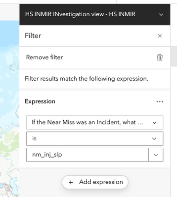

As for the Map Viewer not working... Annoyingly, the AGO interface seems different from Enterprise's 11.3 interface. Also, in my test I used our incident/near miss data, which has over 3000 items this year. The filter seems to be doing what I'd expect it to.
Given that 1) you are in AGO and I can't seem to replicate the issue in Enterprise, and 2) this issue no longer appears to be directly related to S123, I'd suggest making a post in the AGO forms about Map Viewer's Filter capabilities. You are more likely to get good traction there.
