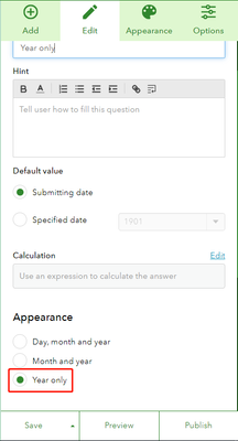

Hello Dave,
You can try selecting the 'year only' option in the appearance options under the edit tab.
