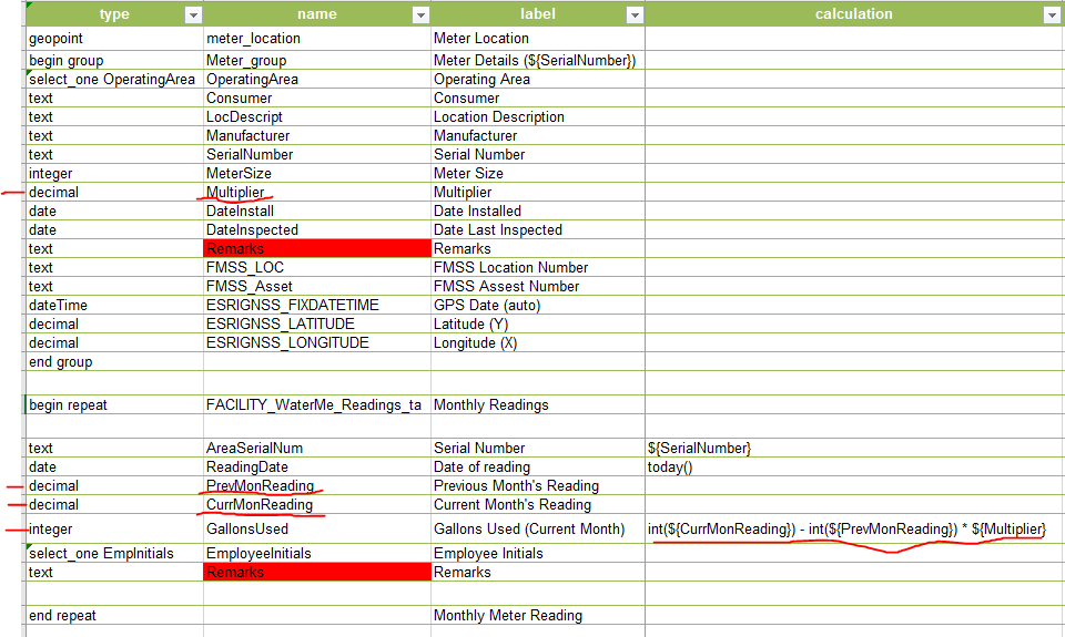

I have a form I created using an existing hosted layer feature on AGOL. The point layer is of water meter locations with a related table for monthly readings. Currently, my form is set for the field crew to type in the current month's reading, type in the Previous month's reading, and multiple that by a multiplier(a field present in the point layer) to get the value of GallonsUsed for the month.
However, ideally, I wanted to somehow pull the Previous's month's reading(the value obtained from the previous repeat of that location) into a new repeat to avoid having to look up and type that value in, thus getting rid of the Previous month reading field altogether.
This is what I currently have in my calculation column:
Is what I want possible? Or we stuck with manually entering the values when creating a new repeat?

Hi Anna
Thank you for providing the XLSForm for your survey.
The max() function Philip Wilson mentioned can be used to return the maximum value from a field in a repeat. However, in this case each time a new repeat record is added and the current meter reading entered, the max() function will read in this new value (essentially overwriting the previous maximum value). This then breaks the subsequent GallonsUsed calculation. The way you've designed your survey (i.e. user manually enters the previous reading each time a repeat is added) is currently the best option to ensure the form works.
We have an open enhancement request to introduce indexed repeat functions (e.g. return value from first repeat, last repeat, repeat x of y, etc.). This would allow you to 'look up' the latest meter reading and use it in another calculation. We will add to this thread any updates on the progress with this enhancement.

Hi Anna,
Are you loading and editing the existing parent record via the Inbox that contains the repeats? If so, at the time of collecting the new repeat record (current month), is the previous months data already loaded in a previous records in the repeat?
Could you use the max() function outside the repeat questions (in parent) layer to get the max value of the data already collected in current month, and then reference that value via a calculation to populate the previous month value (as it should always be the max value when loaded via Inbox?) when adding a new record?
If you could share your xlsx form I could take a closer look, but am hoping the method described above should work.
Phil.

When adding the new record within the repeat; could you use the once() function when pulling the max() function of the repeat in order to retain the calculation that occurs? Something like this below? Maybe you would need to use both entry columns?
(once(max(${lastMeterRead}))) - (${currentMeterRead})
