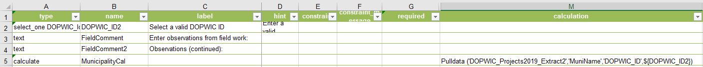

Pulldata calculation is causing "Error converting XLSForm"
Error message says:
>> Something broke the parser. See above for hint.
Error evaluating field 'MunicipalityCal': The problem was located in the calculate expression for ${MunicipalityCal}
XPath evaluation: cannot handle function 'Pulldata'
Caused by: org.javaorsa.xpath.XPathUnhandledException: The problem was located in calculate expresion for ${MunicipalityCal}
      ... 10 more
Survey form layout
Expression says:
Pulldata ('DOPWIC_Projects2019_Extract2','MuniName','DOPWIC_ID',${DOPWIC_ID2})
Maybe something wrong with the path to my 'home' folder?
C:\Users\dmeaney.000\ArcGIS\My Survey Designs\SCIP2019_2

I believe pulldata() should be all lowercase, and there shouldn't be a space in between it and the parentheses. Does your form work after making those changes?
ClaireProctor
Deactivated User
I just ran these checks with the 'calculate location from CSV' sample survey; it's the capital P that's causing the problem, it should be 'pulldata'.
The space is fine, Survey123 just doesn't use it in samples and example formulas in the documentation for style reasons.
DanielMeaney
Yes, that fixed it. Thanks.
