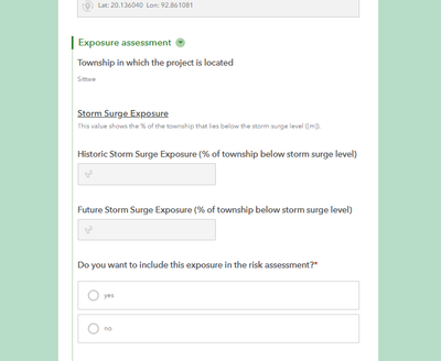

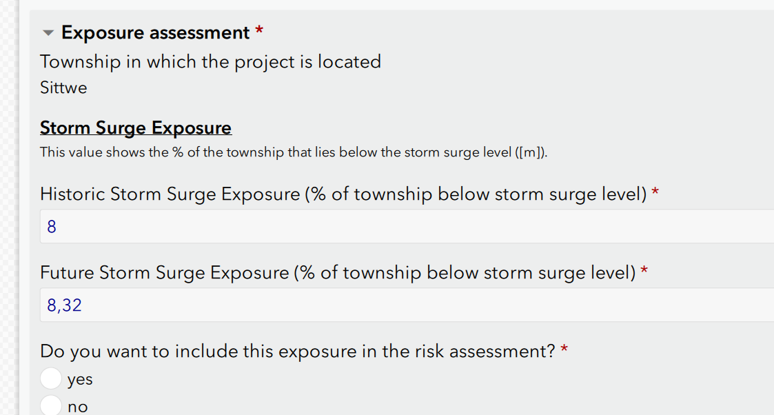

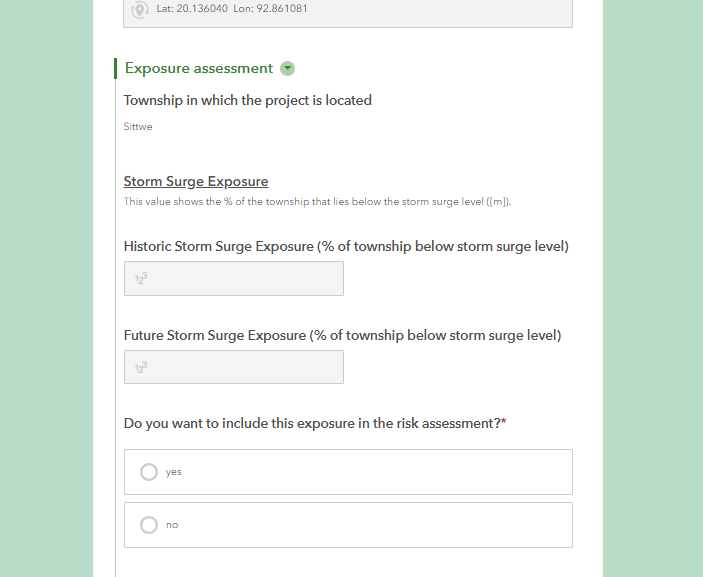

I am having a trouble with my pulldate fields in this survey: RiskAssessment (arcgis.com)
I links to web maps, and should automatically fill in the data. This also works perfect in Connect. But as soon as applying it to the published version, i only find back the community. How can i fix this.

Maartenvan_der_Veen
Hi Doug, Thanks for your super quick response, unfortunately i didnt find the solution with your respons yet...
Looking at the column information:
  • perc_ss_hist (type: esriFieldTypeSmallInteger, alias: perc_ss_hist, SQL Type: sqlTypeSmallInt, nullable: true, editable: true)
it should be the perc_ss_hist right? and not the alias name. Since i have this everywhere, and all columns are not working ii am afraid this is not the reason why it crashed.. this is my function: pulldata("@layer", "getValueAt", "attributes.perc_ss_hist", ${all_hazards}, ${location})
