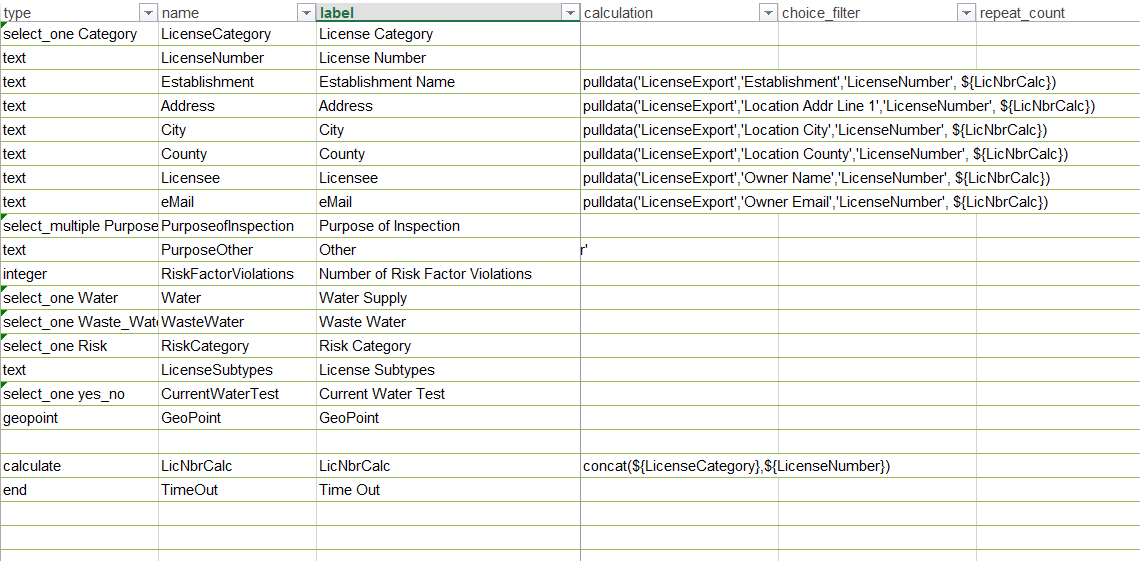

I'm trying to use the pulldata() function as a license record lookup to populate data in a form header.  It seems to work almost all the time, but for some reason it will not return specific records when chosen and I can't figure out why.  It doesn't seem to be a coding issue because it works just fine on other records using the exact same parameters in pulldata().  I thought maybe there were some sort of text character issues, but again, I can't figure out what.  Any suggestions would be appreciated.

Just an example of my data and code I've tried using. The yellow highlighted rows fail to return anything.  The other records work just fine.

Hi Erik,
Is it possible to create a select_one from your LicenseNumber column and test that? I'm not seeing anything obvious (unless there's extra white space in some values- you might want to open the CSV in a text editor and check).

Thanks for the follow-up. I would rather not do a select_one as a permanent fix. There are over 11 thousand records in my full data set. I could erase the majority and test it however.
