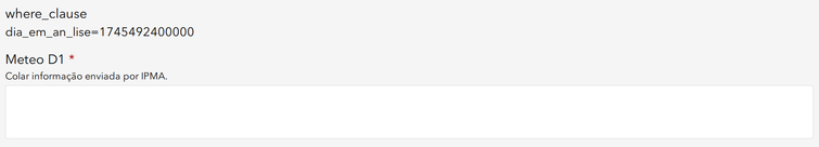

Good evening I have tried to use pulldata(@layer) to automatically fill in a text in a form I want as a calculation where the date of form 1 must be equal to the date of form 2 to be able to use the filtered feature
This is one of the conditions with pull data:
pulldata("@layer", "getValue", "attributes.descritivo_comportamento_de_fog", "https://services-eu1.arcgis.c om/VlrHb7fn5ewYhX6y/arcgis/rest/services/survey123_bd2f7d69157440b3b88384238c9f8a4e/FeatureServer/0", "(dia_em_an_lise NOT BETWEEN CURRENT_TIMESTAMP - 3 AND CURRENT_TIMESTAMP) AND (classe_dia = 'Day 1')")
the code like this is functional but not as I intend it to filter
so its this:
pulldata("@layer","getValue","attributes.meteo_d1",${url}, ${where_clause})
where_clause is: concat("dia_em_an_lise=", ${d1})
The answer is this
Should fill in the text in Meteo D1
And did nothing
In short, the idea is that you fill in the text of an uploaded report in which only the text of the record of the day under analysis is equal to the date uploaded to the form.
Form Date:
Field to be filled from another outer layer:
Thanks

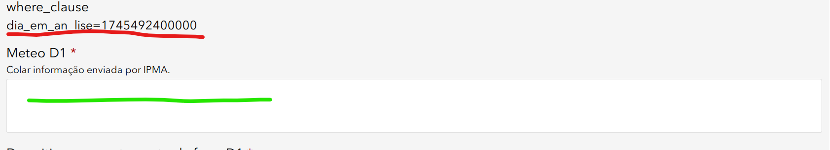

Olá, este é o mesmo código que estou usando, mas já vi que o formato da data é xy/xy/xyzx e 00:00 não entendo que não consegui obter o texto referente a esta expressão
ALANDIA40
Você quer que eu mostre os campos?

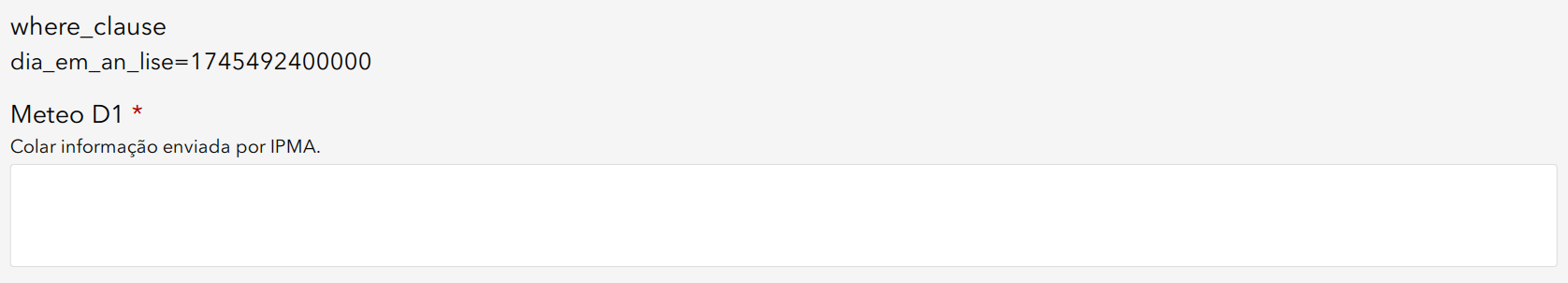

My guess is that the date in your "where clause" does not match the date in the layer you are pulling from.  For example if you used now() in your pull data layer, the date would include time as well. You are using today() in this form and that formats date with default time.  Check to see that your date formats match between the 2.
ALANDIA40
Passei de today() para now() e ainda não aparece o texto me deixa triste é que usar uma expressão diferente não funciona, e mesmo criando formatação de teste nada funcionou, o formato foi configurado e mal configurado e continua o mesmo

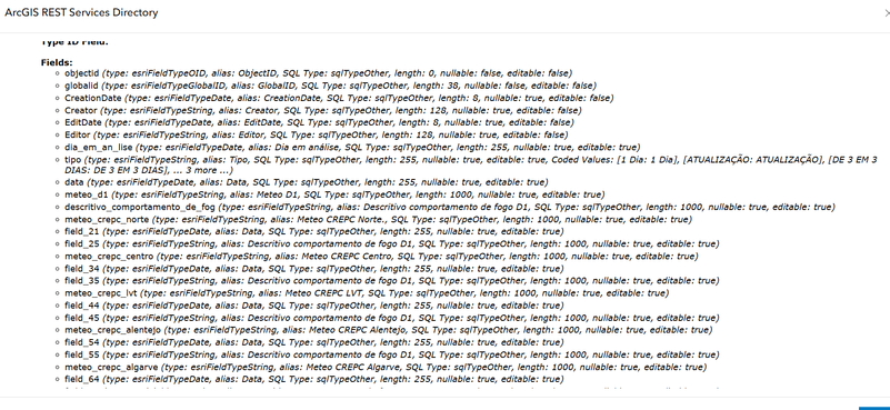

The field you are pulling from is a String field according to your screenshot above. You are trying to match to a date formatted to UTC.  You will need to format one of those to match the other.  Not sure how you are getting the date populated to meteo_d1, but your field right before it "data" is a date field. If the date in that field is the same as the date in meteo_d1 you could try that field for your pulldata calculation.
https://community.esri.com/t5/arcgis-survey123-blog/dates-and-time-in-survey123/ba-p/895528
