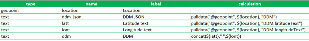

Hello!
I'm trying to pull coordinates from a geopoint question within a survey. I'm able to pull X/Y coordinates into separate fields using the pulldata function. For this project though we need the coordinates in Decimal Degrees Minutes as the output of the pulldata function. Is there a way to specify DDM when using the pulldata function as well as have the coordinates split into two fields?
Image of the current pulldata function. "Location_Error" is the name of the geopoint field.
Thanks.

 XLSForm example attached.
 Check the Extract Geopoint Values help topic for details

DaveK
@IsmaelChivite This worked perfectly, thanks for the help.
