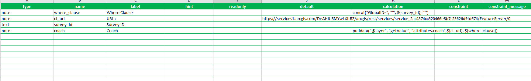

I am running two surveys in parallel. One survey is the parent survey, and the other one is the child survey. I need to upload data from the parent survey to the child survey. The xlsform hereunder, works fine, but it doesn't work offline, and my enumerators won't always have internet.
Is there a way to achieve this so that it works offline. For example is it possible to create a csv in Arcgis that contains the feature layer from my "parent survey" and is updated automatically in Arcgis so that I can do a pulldata() based on this csv ? Many thanks in advance for your support !

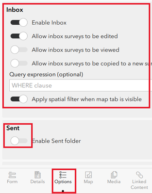

If all users have an account, then the Inbox would be good to look into if you haven't already.
In Connect, you'd go to the "Options" tab > enable the "Inbox" and configure it > disable "Sent" > publish changes
In your field app, you will now see the inbox instead of the "sent" folder (If someone downloaded the form before this update and sent a survey, they will see the "Sent" folder until they either delete the contents from it, or they delete and re-download the survey). If you go into the "Inbox" and click "refresh", your users will download all previously submitted forms by default. They can then edit previous responses.
If you want to filter the Inbox to something like specific dates, or have the author see only their submissions, etc. You can use the WHERE clause to limit Inbox results.
