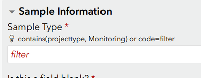

@spf999 One more try.  Your choice filter may be causing the issue....
for both sampinfo_type" and sampinfo_prestype"  try changing the choice filter to just  contains(projecttype, ${projecttype})

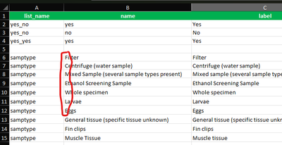

I think the "code=..." part of your choice filter is unnecessary  as it is referencing the question itself, so sort of cyclic dependency going on, but that along with, in your pulldata2026.csv, the samptype is all lowercase and the choices on the choice tab have the names capitalized which is causing a mismatch. So try one or both of those and see if that helps.
If you just change the choice filter first, you will notice the pulldata works but it is in red as it doesn't match the choice filter, which when you have the code=... part actually stops the pulldata from populating.
