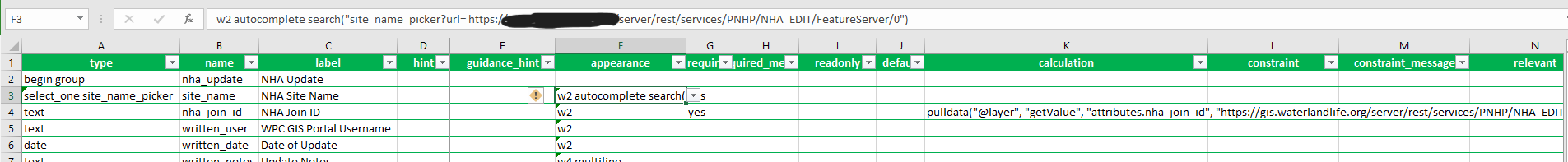

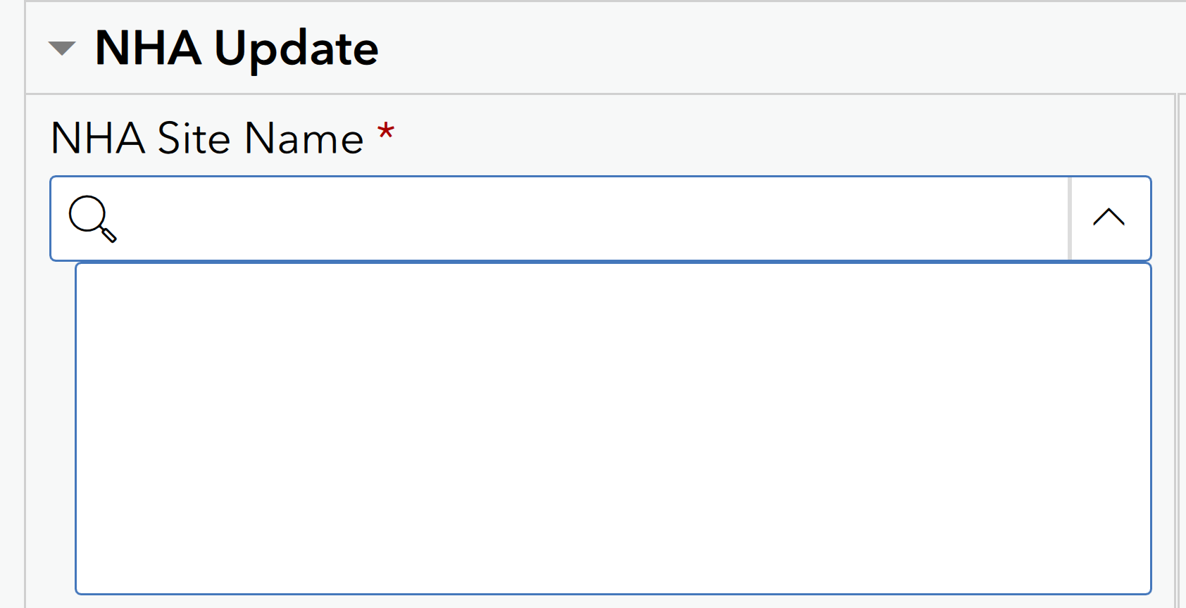

I am setting up a survey to use the search() function to query a feature service layer to auto-populate values in a drop down for users to select. I then want other fields to auto-fill attributes in the Survey123  from the feature service layer with the pulldata() calculation. When I set up these functions, the list is empty and the pulldata() function (when tried separately) is also empty. The feature layer is in a referenced feature service hosted on our enterprise portal and the Survey123 form is being built in the same same portal. What am I doing wrong?
My search() expression in the appearance option:
w2 autocomplete search("site_name_picker?url= https://<enterprise_url>/server/rest/services/PNHP/NHA_EDIT/FeatureServer/0")
My pulldata() expression in the calculate option:
pulldata("@layer", "getValue", "attributes.nha_join_id", "https://<enterprise_url>/server/rest/services/PNHP/NHA_EDIT/FeatureServer/0",concat("site_name='", ${site_name}, "'"))
I've attached photos that show the .xlsx file and the blank drop down list.survey123_1.PNGsurvey123_1.PNGsurvey123_2.PNGsurvey123_2.PNGsurvey123_3.PNGsurvey123_3.PNG

Mysteriously, everything started working after rebooting two days later without changes. I updated to separate the concat() function from the pulldata() function anyway, as you suggested @JenniferAcunto, and everything seems to be functioning well. Thank you for the tip and hopefully it will make things more stable.
