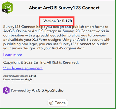

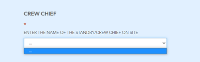

ahargreaves_FW
Thanks @IsmaelChivite but I published with v3.15.178 and have the same issue....
IsmaelChivite
Esri Notable Contributor
@ahargreaves_FW  Please share XLSForm with the corresponding CSV
