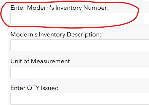

I am beyond frustrated with this even after all the research and and tutorials I have been reviewing and nothing is working. This should be a very simple concept and I am missing something.
Attachment: Enter Inventory Number - The user is to enter the company inventory number (lets say 1050). From there, I would like it to automatically populate the field (Modern's Inventory Description).
I have a hosted feature layer on AGOL that has the Inventory Number and Description.
In the calculation: pulldata("@layer", "getValueAt", "attributes.DESCRIPTION", "PATH TO AGOL", ${Inventory})
However, when I enter 1050 into the survey, the Inventory Description remains blank.
Please help since I am really lost here.

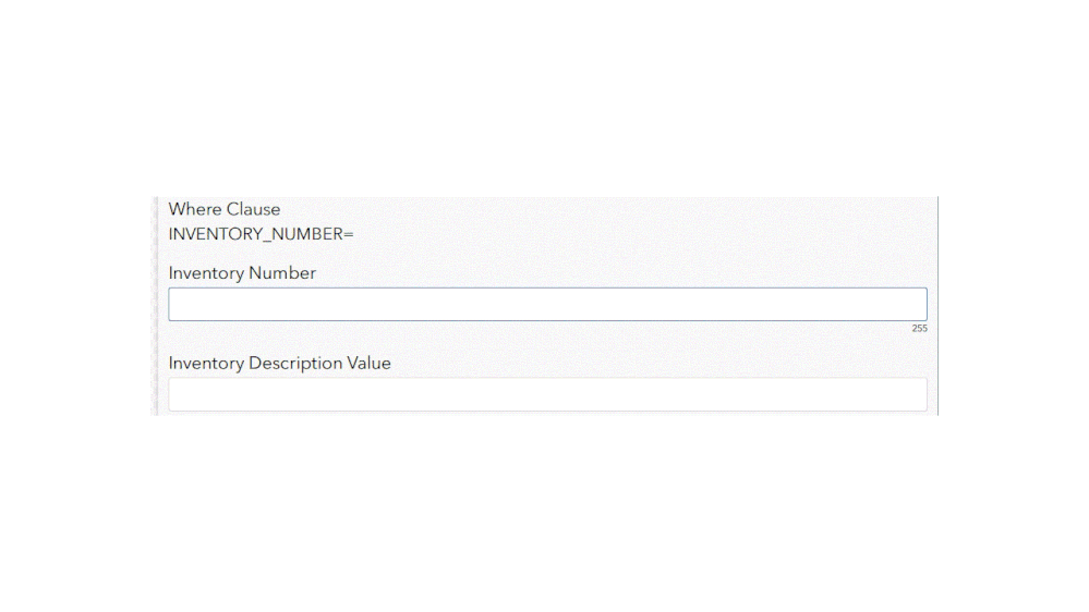

    1: Is there a way to hide the where clause in the survey so it doesn't confuse or crowd the form for the user (Attachment).
    2: In the past, when I could create and publish a survey from Survey123 Connnect and record data, other users complained they could not see recorded surveys from others. Is this a known issue or more of a lack of knowledge on my part?
Appreciate it.
Vinzafy
Awesome! Glad that worked for you. To answer your follow-up questions:
  1. Absolutely! Any line items can be hidden in a survey by setting the appearance for the item (column F) to "hidden".
