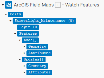

Thanks all for your input. I believe I've tried the iterator method before, but unfortunately, this is a scenario triggered by Field Maps, not Survey123. It appears that attachments aren't accessible through the Field Maps trigger, only the geometry and attributes. My end users are (currently) not editing features in Survey123, so any edits made through Field Maps or an editing widget won't cause the scenario to run if I use Survey123 as the initial trigger.
Also I don't use Portal, just regular old ArcGIS Online storage.

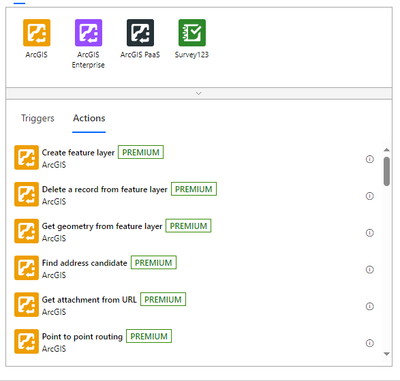

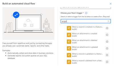

Sorry we weren't able to offer any help! These triggers are available in Power Automate, which would mean any time the feature layer is touched, from Survey123, Field Maps, Online Map Viewer, whichever, that the webhook would be triggered to run the actions.
Or if you have a manual trigger there are actions to grab the attachments at the time as well.
I see yeah it is only the Field Maps one in Make, odd. Does the 'edited' for Watch Features not count if it was an attachment? Or can Make not interact with the attachments on a feature layer at all?

It appears that Field Maps just does not interact with attachments at all, which I believe means I wouldn't be able to use HTTP to pull an attachment if I'm using a Field Maps trigger, because there's no files or URL to pull from.
I've used HTTP to pull attachments when I have the Survey123 trigger, but it appears the Field Maps trigger is just limited by comparison for some reason.
Personally, I don't like Power Automate. Despite knowing it's much more powerful, I just find it incredibly complicated and confusing compared to Make. Plus with many of the more powerful Esri tools behind a paywall of a Premium license, that was another huge factor for me not moving forward with forcing myself to learn it. My IT dept tried to get me a Premium license and our Microsoft licensing company just never gave it to us. That part is nothing against Esri and their tools, more against the weird licensing methods Microsoft uses. But it was a huge roadblock so I just gave up and stuck with Make.
