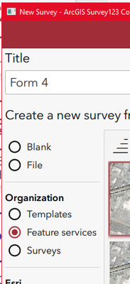

I am trying to remember how to publish a new survey from an existing survey from Survey123 Connect. The steps I have got so far are
Click New Survey -> select Feature Service from XLSForm design -> select feature service -> then Create Survey.
When I open my new survey it still has the existing hosted feature service selected in Linked content and is giving me an error when I go to publish 'if you republish this survey all previously collected data will be lost.'
Isn't Survey123 supposed to automatically generate a new hosted feature service on it's own?
What setting am I not setting to get it to do this without affecting my existing feature service?

I feel as if you are describing two different things?
1. Create survey from existing feature service will place a new survey on top of an existing service. No new feature layer will be created as it will use the original feature layer. Subsequently, any new additions to the feature layer will need to be made in the Portal or from the original survey. (What you described with the linked content is normal).
2. You can use an existing survey to make a new survey. The two surveys are completely separate. Publishing the new survey will create a new feature layer.

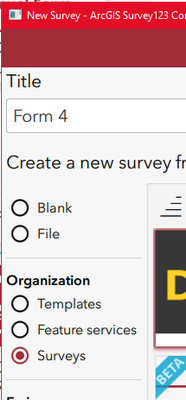

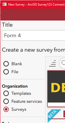

If you are looking for a new Feature Service to be created, then you don't want to choose the "Feature services" option.
Instead, do one of the following:
  • Choose the "Surveys" option and then select the survey you want to base the new one off of.
  • Or, choose the "File" option and provide an existing XLSX.
In either case, when you hit publish you will automatically create a new Feature Layer (you don't need to tell it to do anything - the process is automated).

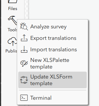

EDIT: Since your Connect is so out of date, you may wish to update your XLSForm once you get the newer Connect. The process is simple: Open the survey > click Tools > and click Update XLSForm template (You can also choose Analyze survey to see if there is anything wrong).

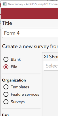

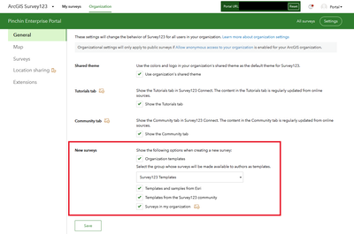

I just noticed one other question after downloading the latest version of Survey123 Connect. I am not seeing Templates and Surveys under Organization. It is just showing Feature Service. Can you tell me why it doesn't show templates and Surveys?
abureaux
MVP Frequent Contributor
You need to enable them. From the S123 Site, go to Organization > Settings:
