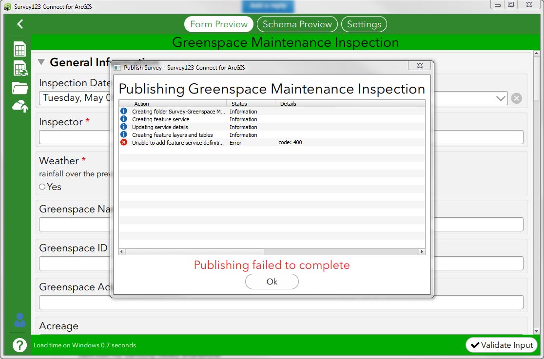

Get the following error when publishing a new survey to ArcGIS Online for Connect v2.7.72
All the field names are lowercase, etc.
I was able to successfully publish a new survey April 2018.

Hi Carl,
The words 'id' and 'comment' are key words in the database used by the hosted data store; can you rename both of them and try to republish (after deleting the folder Connect has made previously)?

JamesTedrick
Esri Esteemed Contributor
Hi Carl,
