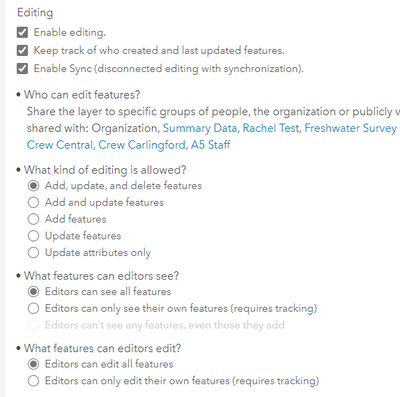

How did you publish the survey (Connect or web designer) and how did you set the sharing permission and editing options, via the Survey123 website Collaboration tab settings, or directly via the AGO Settings tab for the feature service.
There is a setting for editing that allows user to only edit their own features, this could be the cause, by default users can edit all features, but you can change it so they can only edit their own features:

I published it using Survey123 Connect and changed the settings in Portal.
I thought that might have been it, the setting was set to only allow users to edit their own. It would make sense but checking the settings and it is already set to allow editors to edit all features.
