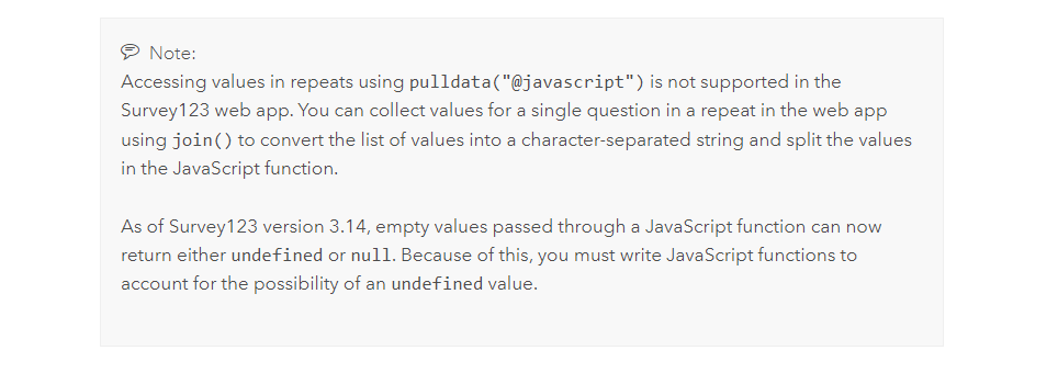

Hi. Sorry to inform: This is a known limitation of the web app. Read this help topic for details.
IsmaelChivite
Esri Notable Contributor
