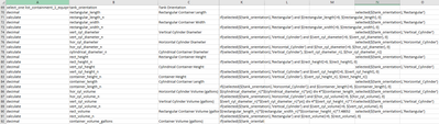

MarkRankin1
Howdy All,
I can figure out how to do addition in a calculate field with integers but have not had any success with decimals.  It keeps concatenating the two fields instead of adding them.  I've also tried using "decimal" and "dec" in the field and get an error when it gets converted to the xlsforms.  ${CASH_VALUE} + ${CASH_VALUE_MP} or dec(${CASH_VALUE}) + dec(${CASH_VALUE_MP}).  I also tried the bind::type method and put decimal in the field and that didn't work.  Any help would be greatly appreciated.
Cheers,
Mark
