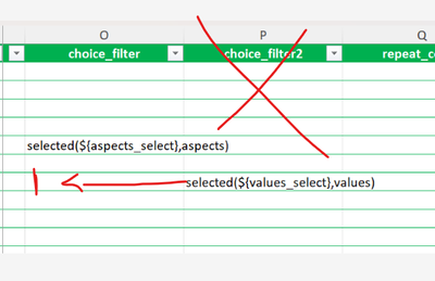

I have been using choice filter to allow for the selected answers from the previous multiple choice select to show up as the only options to rank. This works fine for the first question (aspects) - but when I try to do the same thing for a second question (values) it will not limit the rank options to the multiple choice selected from the previous question. Any help in getting this to work?

No need to add columns on the main xlsx page
also on your choices page you have the heading of "values2", but in your choice filter you have "values"  they need to be consistent.
Edit note: I recreated your example,  you need it to be "values2" in your choice column and choice filter. "values" must be a reserved word.

JessDavis
It worked! Thank you so much.
