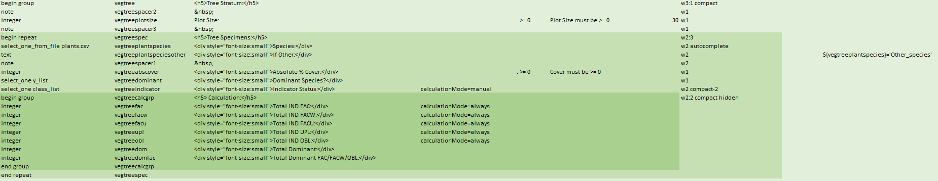

I have a survey built from XLSForms where I have a select_one list on the form (${vegtreeplantspecies}) built from an online csv of plant names (hundreds of plant species).  They are in a repeat group so when someone encounters multiple species they can enter as many as they want. I have an entry in the select_one that has the label "Other - Not Listed" and the name "Other_species". I have a text box in the form (${vegtreeplantspeciesother} triggered by the relevant field if they select the entry "Other - Not Listed" it shows up and they can enter a plant species that is not in the online csv data.  Works fine.
