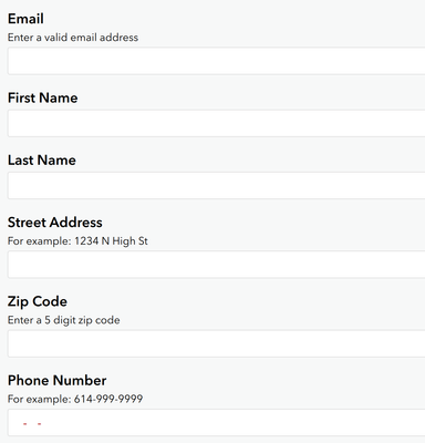

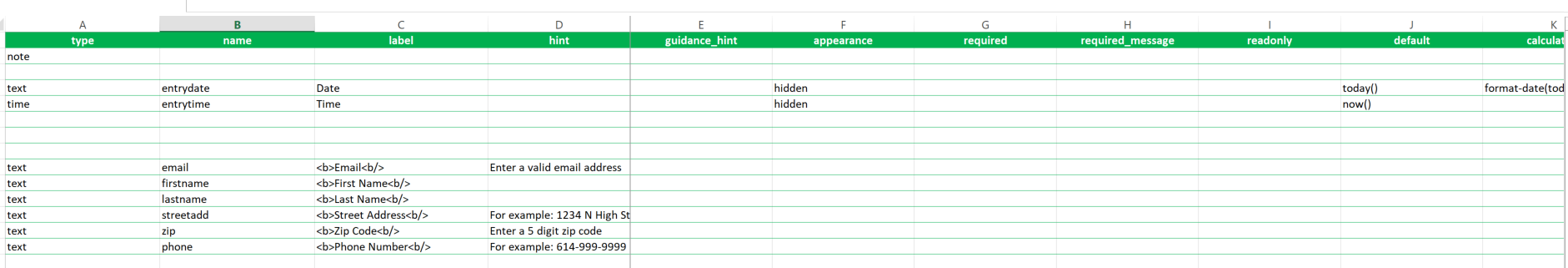

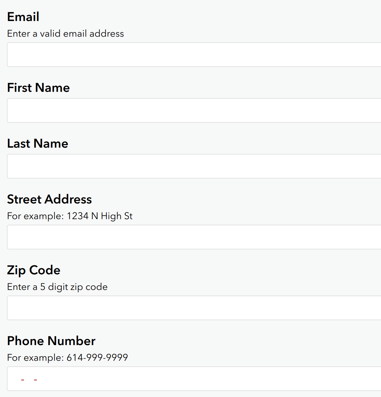

Is there a way to prepopulate certain fields in a new survey entry if there is a previously submitted survey entry that matches for example an email field in both surveys?  What I'm looking to do is take the fields, First Name, Last Name, Street Address, Zip Code, and Phone Number....prepopulate those fields with the previously submitted survey's entries if the email address given for the new survey entry matches the previously submitted survey. I am using Survey123 Connect.  Refuse Survey.PNGRefuse Survey Excel.PNG

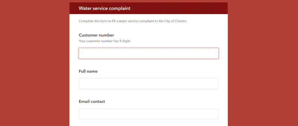

This animation shows an example where the customer number is used to feed the pulldata("@layer") query

I have attached a sample XLSForm so you can see how it can be done but essentially, it would look like this:
Line 2 takes the entered user_email in Line 1 and queries the layer URL specified in Line 4. The output of the query is used to populate Line 2.
The URL specified in Line 4 is the URL of the survey layer itself. You can hide the text question type in Line 4 by adding the keyword hidden into the appearance column
