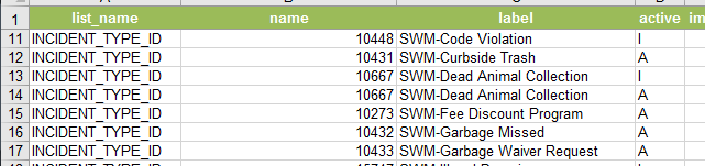

I have set up a choice filter that limits my INCIDENT_TYPE_ID based on my SWF_STATUS:
active=${SWF_STATUS}
The appearance of my INCIDENT_TYPE_ID is set to minimal (as per other question entry suggestions).

JohnathanHasthorpe
Hi Erick
I tested your survey and it works - apart from the fact that the service id has a strike-through (due to the fact the value is not in the choice list):
The only thing I modified was the survey ID. Can you let me know what device and platform you are using?
