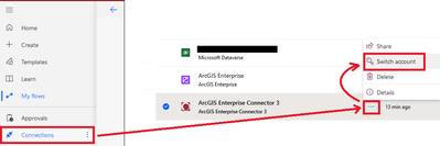

How I refresh Connections is as follows:
I'm in Power Automate almost every day and this action is barley a few seconds, so it isn't terribly disruptive to my workflows.
Making a new connection works as well, but then you end up with tons of dead and dying connections on this page (Hence why my primary Connection that hundreds of flows are based off has a "3" in its name! When I first started in Power Automate, I remade several connections before I realized what was happening).
