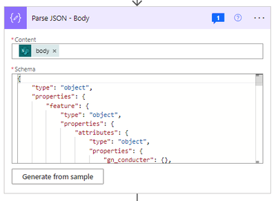

Honestly, I am not familiar with this bug. However, I would suggest that you use Parse JSON. The first thing I have in my S123 flows is this step, and Power Automate only references this Parse JSON step rather than the Initial Survey Response.
In your particular case, if you did need to delete and readd the Connector, then you would only need to change this one step rather than the entire flow.
Doesn't really help your current situation, but may at least prevent this from being a future headache.
