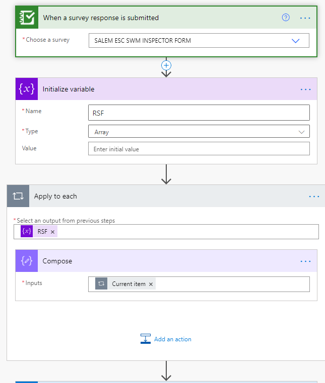

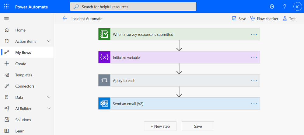

Thank you, Ismael. So I was able to create a flow, yet there items in the repeat section did not show in my "test" email. The only items that showed in the email were two brackets. I assume there should be some sort of data within those brackets. You mentioned appending the output of the "RSF" variable, but I am unsure what to append that data too.  Please see workflow below.
JasonSimpson

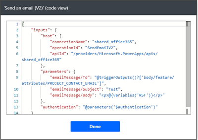

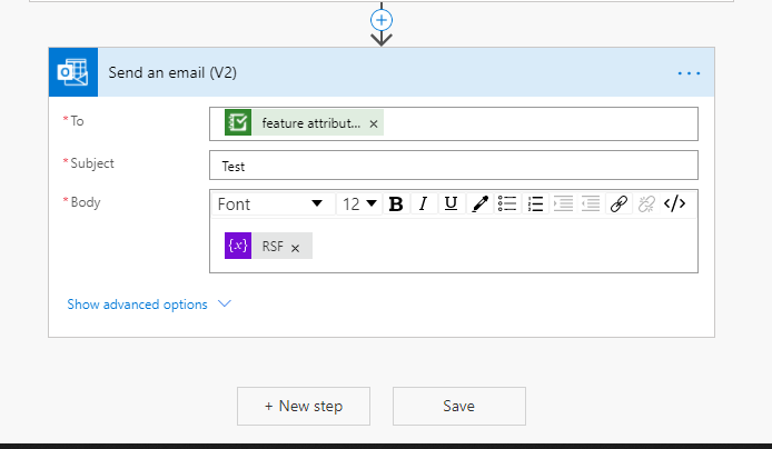

Also below are peeks into my code.
Initialize Variable
Compose
Email
It appears to me that the RSF out is included in a paragraph, but yet it does not show up in the email after I submit a survey.
