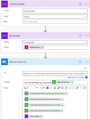

Thought about it a little longer and I remembered that it is possible to include content that doesn't appear in the dynamic content. In this post from 2018, in the section "Handling Dynamic Content from Survey123. A few tips", it describes how to include hidden content. In PA, I set a variable and initialized a variable with an expression to convert the UNIX time to readable time.
addseconds('1970-1-1', Div(triggerBody()?['feature']?['attributes']?['closing_date'],1000) , 'yyyy-MM-dd')
This allows the content to be added to the email body.

@MikeOnzay  and @Richard_Purkis, I'm using the
suggested by @MikeOnzay , but I'm still getting the wrong date (August 28, 5217 while it should be February 16, 2024). Have you seen anything similar? Any suggestions?
