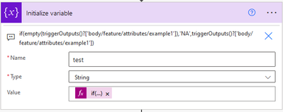

  • In PA, you can use an expression to test a field for null and conditionally add data. E.g.,
    if(empty(triggerOutputs()?['body/feature/attributes/example1']),'NA',triggerOutputs()?['body/feature/attributes/example1'])
    EDIT: I realized that the PA expression probably doesn't make a lot of sense if you've never seen it before, so I added coloring. In your case, Red=Universal (don't change) and Blue=Dynamic (change these to be your desired fields).
