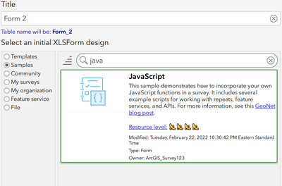

Without knowing the overall structure of the from itself, if the weather information you are loading is constant throughout the entire repeat, you can use pulldata() + JavaScript to be able to pull weather information from an API directly into Survey123.
There is a JavaScript sample survey that contains what this workflow could look like in Survey123 Connect:
