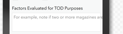

StaceyRose
The hint is wrapped automatically but if you want to display that hint as a placeholder (using placeholderText=@[hint] in the body::esri:style column) inside of a multiline text box which can be automatically typed over, it does not wrap. I want the hint depicted as a placeholder within the textbox to wrap instead of continue on into infinity on one line. This is currently what it looks like. I feel there must be a way to modify this.
Neal_t_k
MVP Regular Contributor
You could add "<br>"  where you want the breaks in your hint to be if it is static text.
