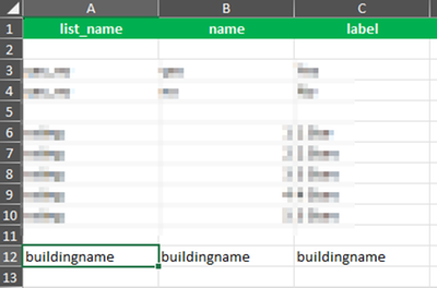

In the choices tab, enter the list name (doesn't matter what I call it), the name (must be the field name in the feature service that I want to pull values from), and the label field (doesn't matter what I call it). Here's my config:

You don't need to (and probably shouldn't) use the same key term 'buildingname' for everything. You're tripping yourself up.
change your choice list:
  • list_name = building_name_list
    • This is just a name for your list in the survey. Make it obvious it's the list.
  • name = 'buildingname'
    • This should be the actual field name in your service you are trying to search for to create your choice list.
  • label = 'buildingname'
In your survey form:
  • type = select_one building_name_list
  • name = buildingname
    • I'm assuming you're searching this field / the same service
  • label = What building has the issue?
Now the expected formula for search() is:
search(tableName, searchType, searchColumn, searchText, filterColumn, filterText)
For your tablename, you need a URL preceded by a unique table name that doesn't match anything else in your Survey123 form. So call this literally anything but any other table or csv name in your survey. I don't think technically you have a table/csv name in your survey that may cause issues, but it's just not unique, it's confusing. Call it 'cats' or 'notarealtablename'.
The tableName with the URL is your only required parameter. The below will work. If it doesn't, check you have access to the service:
search(cats?url=https://services.arcgis.com/......./0)
You have added a search type for 'contains', a spatial search, and then a column 'buildingnames'. This would be expected for text based searches, where 'contains' expects a geometry. I assume you are trying to pull the buildingnames fieldnames for your choice list - this is what the name/label columns in the choices sheet are for. The search() parameters are for text based filtering. If you need to filter the results let us know and we can help build it. If you don't need to filter, query or apply a spatial search - just use the above search(tablename) without any additional parameters.

AmyRoust
Mystery solved. This only works with a hosted feature service, and I was using a user-managed service from my Portal.

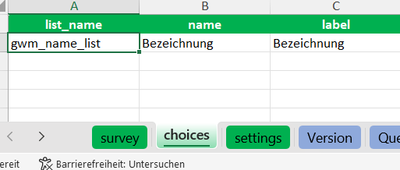

Hi Amy, I use the search from a featureservice with referencing the field in the choices tab in the xlsform. i.e. I search in the GWM layer from the featureservice in the field "Bezeichnung" like this:
the formula in the appearance field in xlsform looks like this:

The field name is the name in your choices sheet. I used it in the example.
