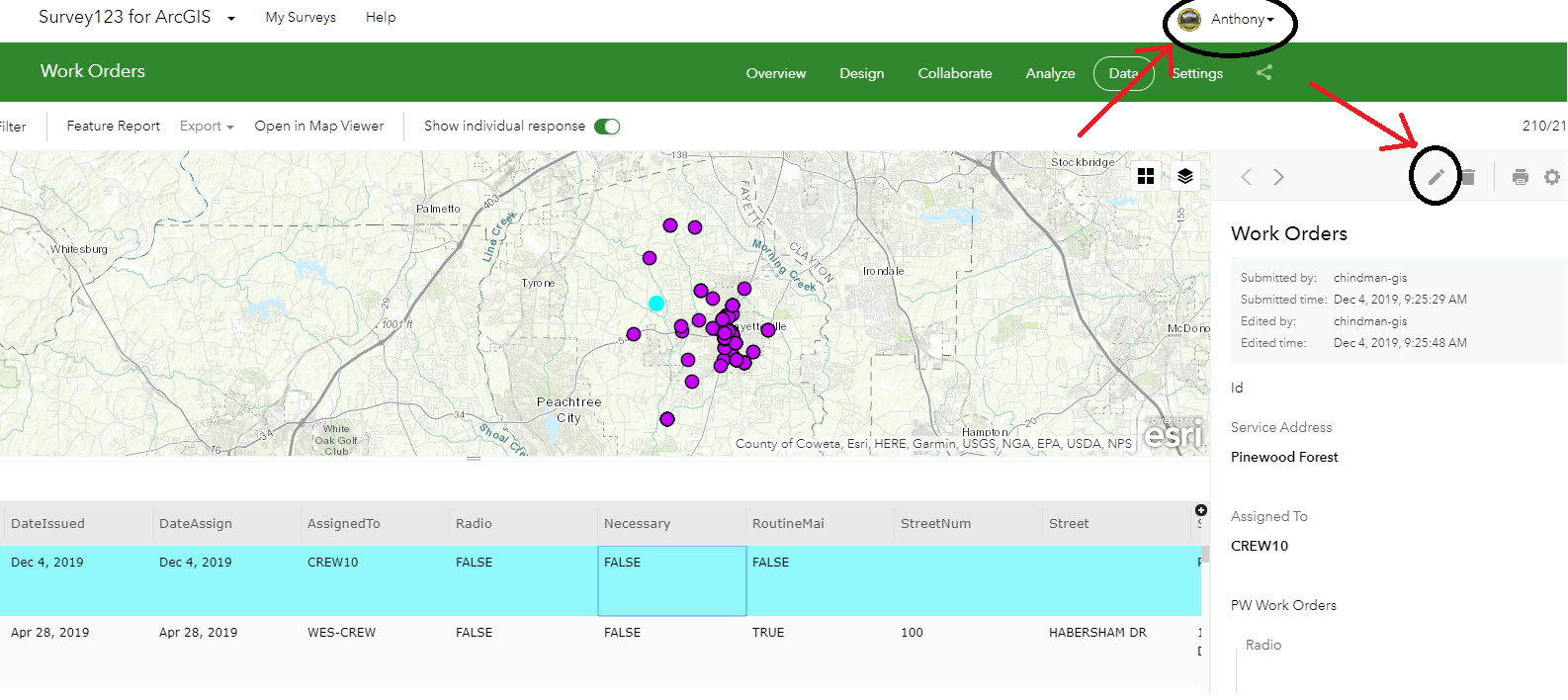

In my current survey and as an owner I of course can edit my data. However, I am having issues setting up other individuals with the same permissions (to edit data)
Pic 1: Owner - can edit
Owner can edit

So after continued reading here it appears that only the 'Owner' can update Survey data from the back-end. Can someone confirm that this is still the case?
Thanks!
JamesTedrick
Esri Esteemed Contributor
Hi Anthony,
The owner of the survey can update all data via the Survey123 website.  A submitter who has also been shared viewing abilities will be able to update their submissions via the Survey123 website; please refer to the table at Share survey results—Survey123 for ArcGIS | Documentation .
You can also create an editing application using one of the many configurable app templates in ArcGIS Online if you need a more comprehensive editing solution - see Choose a configurable app—ArcGIS Online Help | Documentation and Web App Builder's Edit widget—Web AppBuilder for ArcGIS | Documentation
