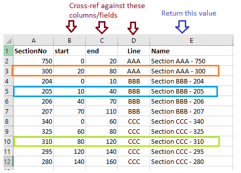

Example of the dataset and the results I want to be returned... Say my CSV dataset contains the following fields:
and I have stations which are at measured kms along its specific line, I want to be able to return the value from Column E based on the criteria that satisfy columns B, C and D above.

You can use pulldata to do this (kind of.....). Pulldata can only do a lookup against a single field in the .csv (not multiple fields), so you will need to create a new version of the .csv that contains a concatenated version of columns B, C, D. The .csv would need to contain rows for all possible combinations of B, C and D - and this is the bit that may be a showstopper for you as you are dealing with lengths.
E.g of concatenated string:
20_80_AAA
Then the pull data function in S123 would look something like the following
 pulldata(<csvfile>, <returnColumn>, <lookupColumn>, <lookupValue>).
The  <lookupValue> would be populated with a concat statement that would combine the results of the appropriate questions e.g.:
concat(${Start},'_',${End}, '_',${Line}

Creating a combinations of B,C and D is one way of creating a unique entry. However, how is it going to work when my asset falls between the Start and End of the concatenated field? Will this string be able to query a number between a range of values?
In your example, if I have asset sitting at 30.5, how would it be able to recognize that “20_80_AAA” is the referred pulldata, rather that returning the first entry which would be incorrect?
