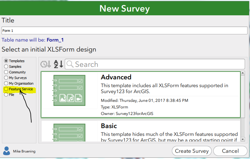

  3. then select the "Create from Feature Class" (see first screenshot),

first screenshot

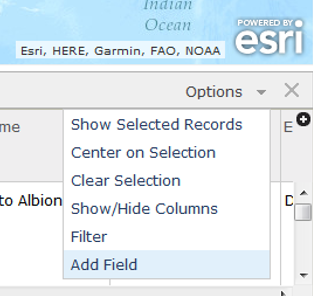

You may need to add fields; high accuracy data fields from the blog, to the existing assets point layer from within the ArcGIS Online Map viewer table viewer

first screenshot
