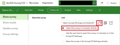

Another way to look at this, which is simpler, is to go to the Survey123 Website, locate your survey, go to the "Collaborate" tab, and copy the string there (imaged below). They, just add &field:destination_field=source_field to the end
