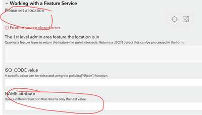

Hello,
I am trying to pass location in xy or address format from Workforce to a Survey. I want to be able to populate a text field in Connect with the coordinates or the address and then convert to coordinates, so that I can use it as a parameter for the 'Working with a feature service' Javascript example published by Survey123.
I want to be able to determine what district the survey is in using that script, it works good on its own, but with Workforce not so much.
Passing Workforce Location is fine, but in Workforce when you click on the map an xy populates the location, while searching for an address populates the location field in address format. Therefore it cant be expected of end users to consistently submit an assignment with either or.
I was wondering if anyone had any ideas, I'm thinking there might be a way to calculate a location field in survey123  that accounts for either address or xy but im not sure how to go about it. I am aware of the geocode and reverse geocode functions, but how to account for both formats I'm not sure. I'm new to Connect and super new to Javascript so thank you for any advice.
Here is the script im using;

 Here is the form for reference as you see it in the example.
Here is the excel that comes with it as well.
geopointlocationPlease set a location
hiddenadminURLURL for feature layer of 1st level admin boundariesThe URL is added as a hidden question to make the pulldata() function more readable and so that it can be changed outside of the script.https://services.arcgis.com/P3ePLMYs2RVChkJx/arcgis/rest/services/World_Administrative_Divisions/Fea...     null
noteadminFeatureThe 1st level admin area feature the location is inQueries a feature layer to return the feature the point intersects. Returns a JSON object that can be processed in the form.multiline    pulldata("@javascript", "url_requests.js", "featureByLocation", ${adminURL}, string(${location}))     null100000
textadminISOISO_CODE valueA specific value can be extracted using the pulldata("@json") function.    pulldata("@json", ${adminFeature}, "attributes.ISO_CODE")
textadminNameNAME attributeUses a different function that returns only the text value.    pulldata("@javascript", "url_requests.js", "fieldValueByLocation", ${adminURL}, string(${location}), 'NAME')
Jing_Sun
Hi, Assuming your workflow is:
(1) In Workforce, click on an assignment point and then click on a button like "Survey at Assignment" to open a Survey123 form.
(2) And in Survey123 you want to get the coordinates of that assignment point and put them into a text field.
Because the integration between Workforce and Survey123 by default passes the coordinates to the opened form (regardless of whether there's a geopoint question or not), we just need to extract the coordinates from the form or the geopoint question.
To confirm the integration is passing the coordinates, you can check the integration URL within the Workforce feature service.
You can refer to the 'Extract geopoint values' section of this page to use the pulldata() function to extract the 'x' and 'y': https://doc.arcgis.com/en/survey123/desktop/create-surveys/geopoints.htm
I hope this will help.
