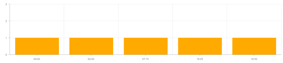

Hi, I have a hidden field (TimeCopy) with calculate format-date(${InterceptTime}, '%H:%M') to extract the time only from a DateTime field. The field automatically outputs to field type String, which doesn’t display the way I need it to when displayed in a serial chart format in the Dashboard. Each timestamps are shown as one bar in the chart, so 18:25 and 18:30 would be separate bars as below. I need a chart to show in hourly ranges, with every entry within the same hour counted and displayed in a single bar.

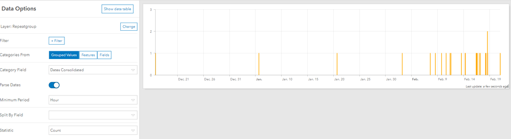

I tried creating a serial chart with just the datetime field instead, with Parse dates ticked and minimum set as Hour. This still displays all the different dates as well, so doesn’t return what I am looking for.

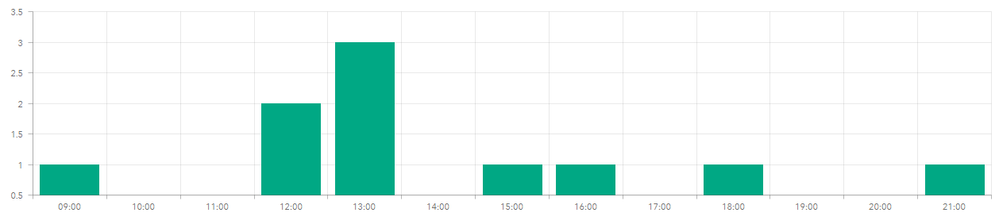

Below is an example of what I am trying to achieve.

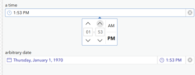

For the arbitrary date, just hard-code a value into the formula in the standard YYYY-MM-DD format.
format-date(${InterceptTime}, '1970-01-01 %H:%M')
