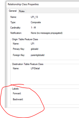

Any finally can we please, pretty please, get the relationship names fixed.  I have posted about this a few times over the years.  It would a easy fix not sure the issue here.

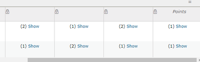

Here is the example.  The first 3 columns are 123 relationships classes.  The name is missing so it is impossible to tell my 3 repeats apart.  The 4th column is my own relationship with proper naming.

@Anonymous User   Checking in on the labels for relationships classes still being blank.  Got support calls on it again this week.
We have many relates so it is super confusing for them to all show as blank in the table.
As I posted before the label is not being filled out is all.  Should be a simple fix.  As far as I can tell it has been incorrect since v1.
