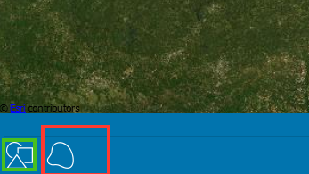

Phil asked me to take a look at this. Just to clarify, your field staff are only having this issue with the 'freehand' tool for capturing a sketch geoshape geometry, but not the 'smart-shapes' tool - is this right? Also, is the error messge shown when drawing the area or when submitting the survey? I've set up a test survey by publishing your XLSForm to AGOL from Connect but I'm not able to reproduce this error. I've tried both capture tools with versions 3.10.326 or 3.11.164 (released last week) of the field app on Windows, iOS or Android.
The log file suggests that the polygon being entered does not have enough vertices (ie it must have at least 3). I'm struggling to understand how this can even be entered, especially with the freehand sketch tool. Even when using the 'vertex' tool (by adding the method=vertex parameter in the body::esri:style column of XLSForm) the 'confirm geometry' button is greyed out until at least 3 vertices are captured:
