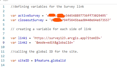

In my pop-up, I have two links. One opens the survey in the browser, the other on mobile (as this survey is so big, opening it in an iPad browser doesn't work well). Whenever I try to click the link that would open the survey in the (iPad) Survey123 app, it causes a loop between downloading and unpacking the survey.

So, I have two surveys (the initial and an update survey) that don't open in the app, but the URL is the same for both, other than the survey ID (x'ing out a few parts of the URL):
https://survey123.arcgis.app/?itemID=exxxccxxxe344548897736ff73029495?mode=edit&globalId=de63aef4-xx...
I got the URL to open the app from the Survey123 website. What do you think could be weird with this URL?

Try "&" instead of "?":
Also, looks like you have an extra "/" right after "app". Should be "app?":
leahmaps
Yes! the &mode=edit worked to open the survey without any loading, but now is not grabbing the referenced global ID. Now, it opens a new survey instead of relating to the record the popup is from.
The interesting thing is, I don't know where the additional "/" is coming from. I have this running in arcade to calculate the URL, and there is not an extra /

My links have that / in them as well and it doesn't seem to cause any issues.
The way I use the globalID though is &filter=globalid:{globalid} and it seems to work for me, try adding the filter=?
