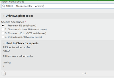

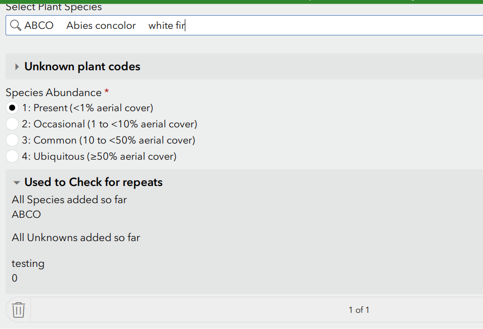

When I use once(join)) inside of a repeat the first records works differently.  It adds it right away where all other repeats adds it after the move to the next repeat.  I am trying to get around this using position but I use pages which means it is in a group which means it always returns 0.

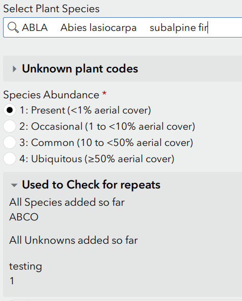

First repeat
Second repeat is the same

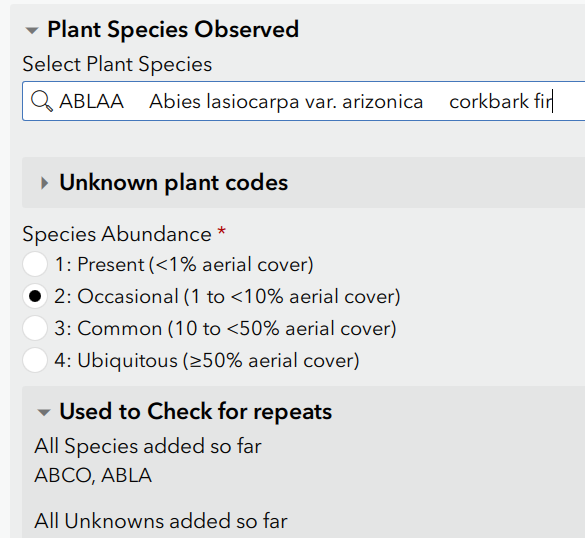

3rd repeat see how the last value is not on the list.

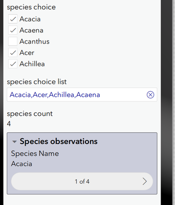

Thanks, I figured out I wasn't actually needing to use the once() function. I wanted to have a select multiple that populated into repeats but also updated itself when the select multiple list was changed, but regardless of the order they were selected.
Instead I used this: selected-at(${species_choice},position(..)-1)

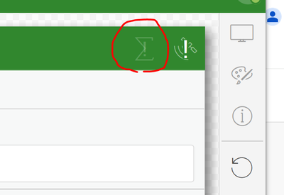

position can cause looping in your form so watch out for that.  In Connect open your form and then wait a minute or two and see if this symbol pops up in the upper right corner.
I had to take position out of all my forms as it would loop to infinity and started to cause slow or crashing forms.  It will seem ok at first, but if that symbol shows up do not ignore it.
