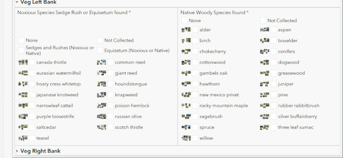

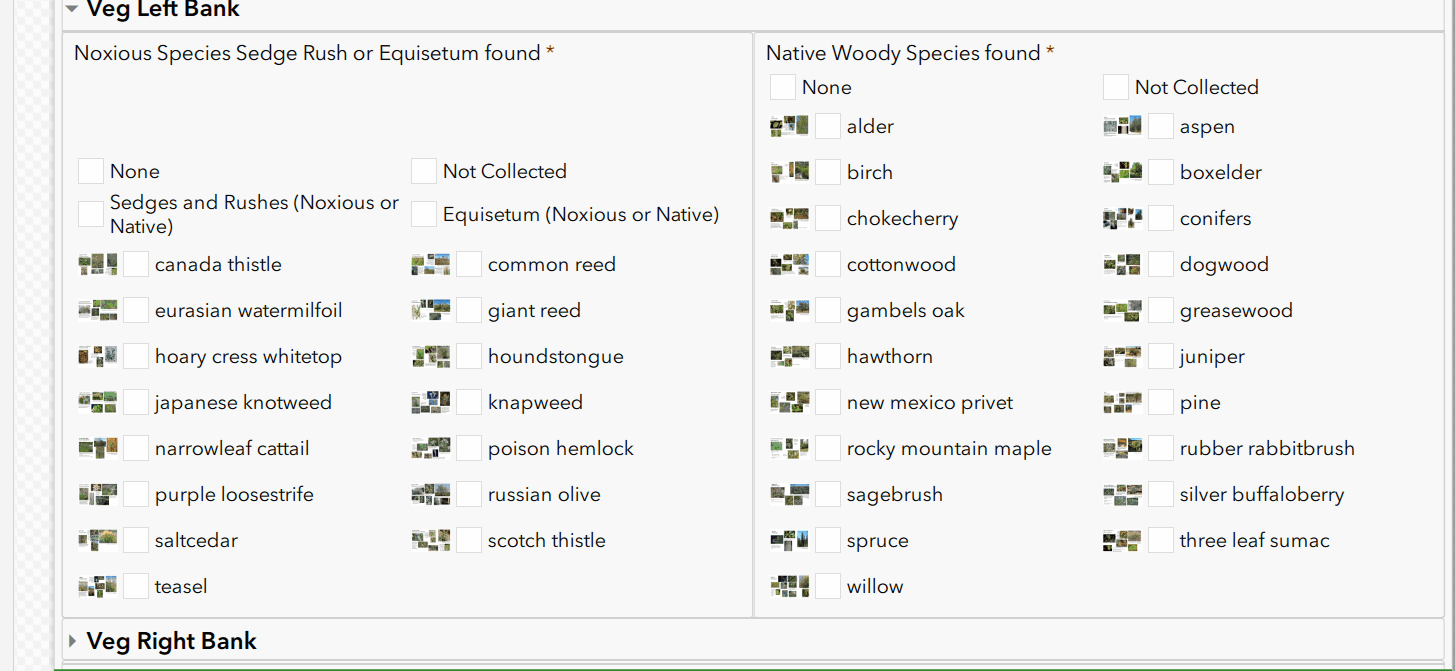

I use images for each choice and it works well.  I can then have text and photos.

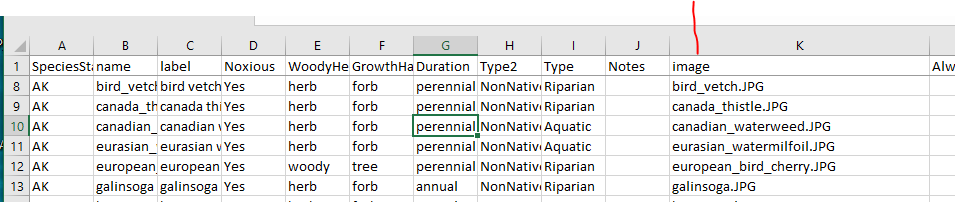

Just use the image column in the choices list tab or in an external csv for each option like this.  Just add the images to the media folder. Note the files names are case sensitive.
Hope that helps
