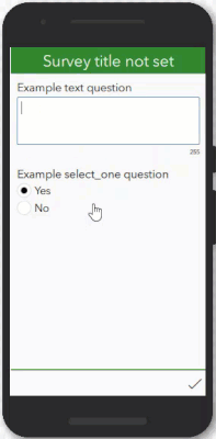

Thanks for providing the screen recording and XLSForm, this is very helpful. What you are seeing is not new to iOS15 or the latest Survey123 3.13 release. This behaviour of the keyboard has always occured with iOS. Actually it also occurs on all other OS, but may be less obvious depending on how the on-screen keyboard works.
The reason for this issue is due to change of focus in the application, in this case a change not occuring. As you can see from the "flashing cursor" below, even when selecting the radio buttons in the select one question, the focus of the cursor is still in the text box, meaning the OS will think the keyboard should still be open. In the case of Survey123, the radio buttons (select one questions) do not cause the focus to change, so the OS keeps the keyboard open.
To close the keyboard you can simply swipe down over the keyboard, and it will close, if you are on in iPad or other OS (Android, Windows devices) there is normally a button on the on-screen keyboard with a down arrow/close option, to close the keyboard when not needed. On iPhones, the keyboard is smaller and doesn't have this button, so you can just swipe down over it.

@Anonymous User I have the opposite problem of the keyboard not disappearing on an iPhone 13 Pro running iOS 15.0.2. When the user is typing in a multiline comment field and then the go to the next field, despite clicking on radio buttons or checkboxes the keyboard still stays on-screen. The only way to get rid of it is to exit the survey and then hit continue survey. Is this a bug? Thanks!

Hi @FredMitchell,
Thanks for reporting this, it could be related to the latest iOS 15 update. We have not been able to reproduce this internally with our testing, so woudl require more information. Can you provide a screen recording of the issue.
Also, are you able to share your XLSForm (and media folder) so we can take a look with your specific form, as it could be related to the type of questions and order of them. If you do not want to share here, you can send me private message.

Hi @FredMitchell,
