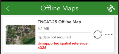

Offline Map: Unsupported spatial reference: 4326
447
05-16-2025 06:13 AM
dwold
I linked a map to use for offline instances, and see this error:
Some documents say to make sure the map is in WGS 1984 Web Mercator (auxiliary sphere), which this is.
Anyone else come across this?
DanPatterson
MVP Esteemed Contributor
EPSG Geodetic Parameter Dataset - Wikipedia
EPSG:4326 is a datum for the geographic coordinate system
EPSG:3857 is the web mercator projection of 4326 data
... sort of retired...
DanPatterson
GlenterpriseUK
Hi @dwold,
Adding to what Dan said above, please consult the online documentation:
https://doc.arcgis.com/en/survey123/desktop/create-surveys/preparebasemaps.htm#:~:text=Survey123%20s...
If you are using any type of packages, check that the data is in the same Web Mercator Auxiliary Sphere projection
Regards,
Glen
