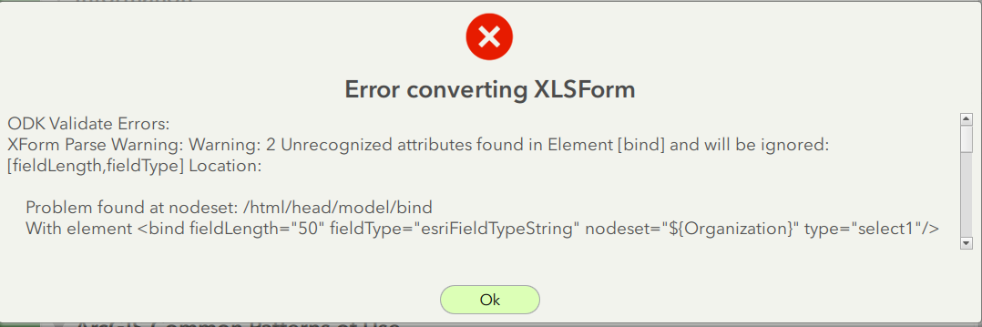

I created a form using Web Designer and am now trying to update the form using Survey123 Connect 2.7.72 on Windows 10. I get the following error when saving the XLSForm:

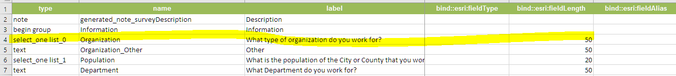

And here is the row from the XLSForm:
Everything looks fine to me - I can't figure out why the error message is occurring. Any suggestions?
Or am I missing something obvious?

Hi Shane,
Unfortunately, it is not currently possible to update the schema of a survey initially created using web designer, using Survey123 Connect, as listed here I can't make schema updates in Survey123 Connect to my survey initially created in the Survey123 web....
In the meantime, you can attempt a workaround to the issue, which involves navigating to the survey's folder within your ArcGIS Online Content folder,deleting the Feature Layer View, and attempting to publish again.
We are hoping to address this issue in a future release of Survey123.
